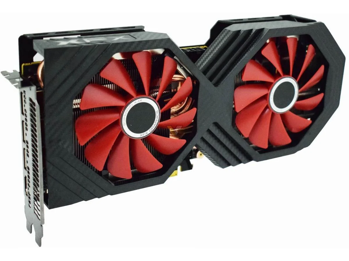

20 hours wow, congrats on such low temps.
Damn that looks like the Strix Owls ugly sister.
Yea bit of chrome or something would be nicer. I dont like that red either. But isnt a tiny card like that made to go into a special smaller case that isnt then displaying anything inside because its tucked away in a living room maybe

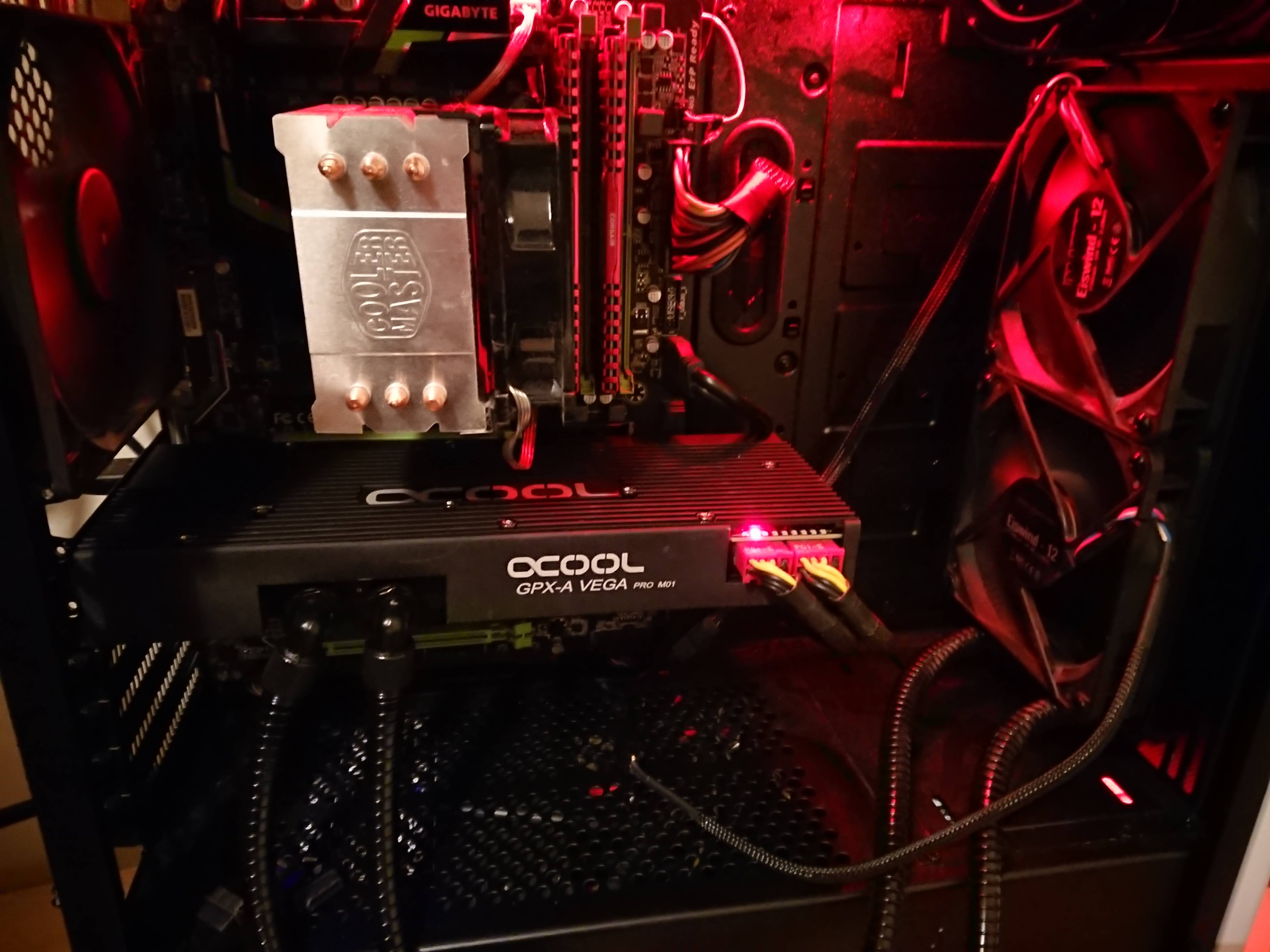

How long has that been running at load as those temps are very impressive, especially at 1800mhz and 1200mV.
Though much be cold in that room to be idling at 19℃
Yeah it's pretty cold in here until i run the card like that lol
I knew it was a good one when i was running stock 56 bios and cooler, thats why i found it very necessary to get liquid cooled e.t.c
Do you know of how to change the reg to allow up to +200% powerlimit, i got much better scores using 64 air bios at 1750 core 1100 hbm, that on liquid bios 1750 1100

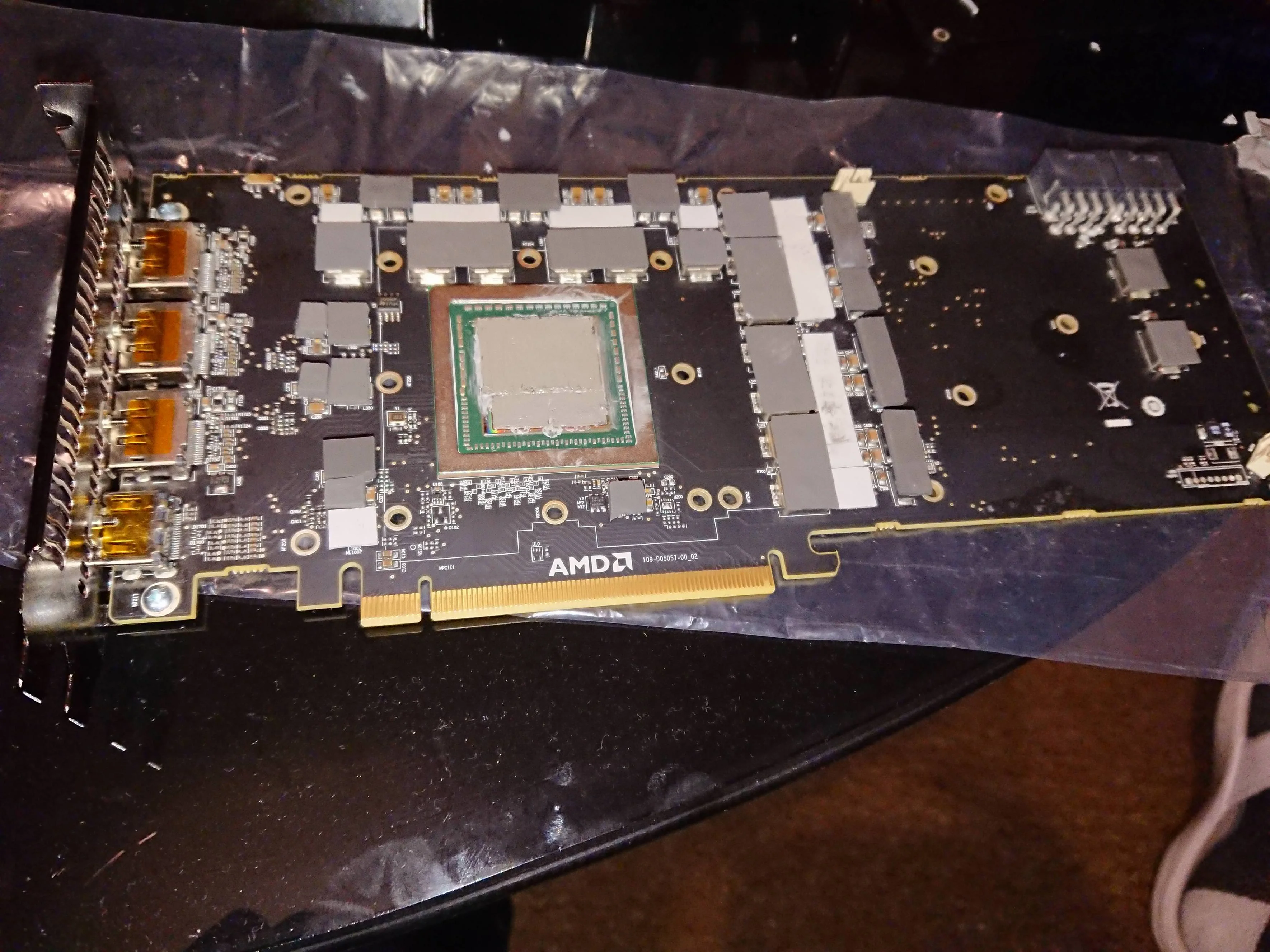

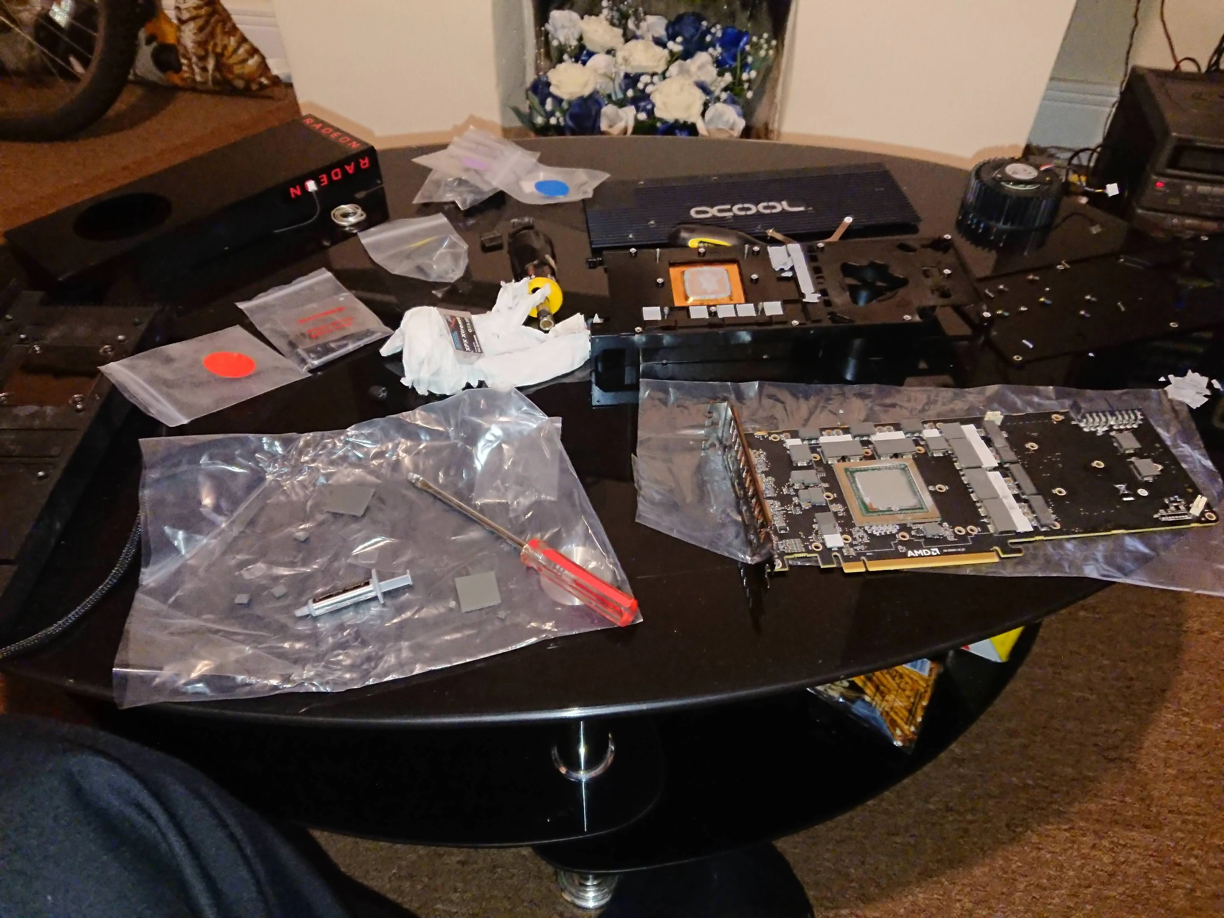

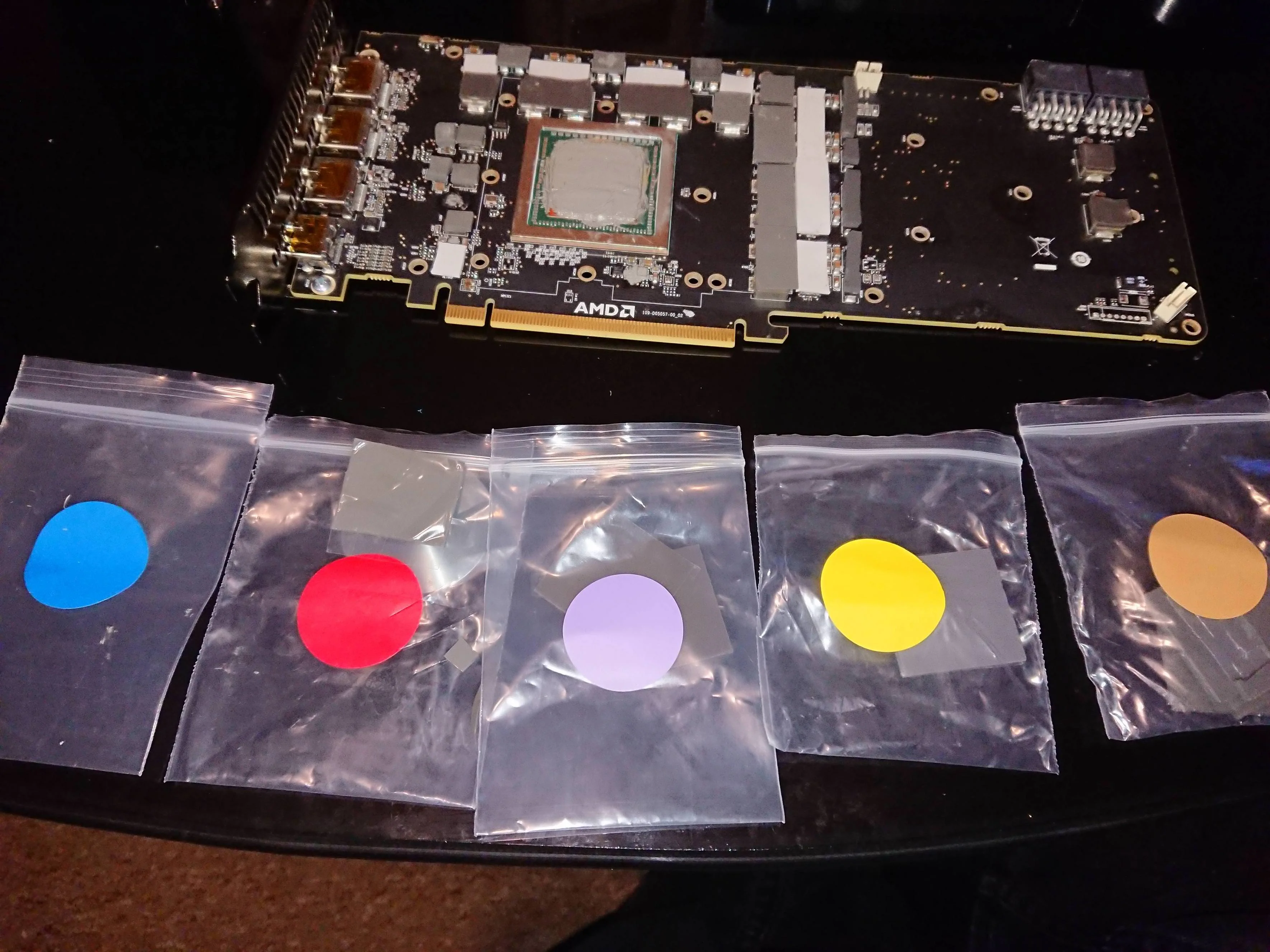

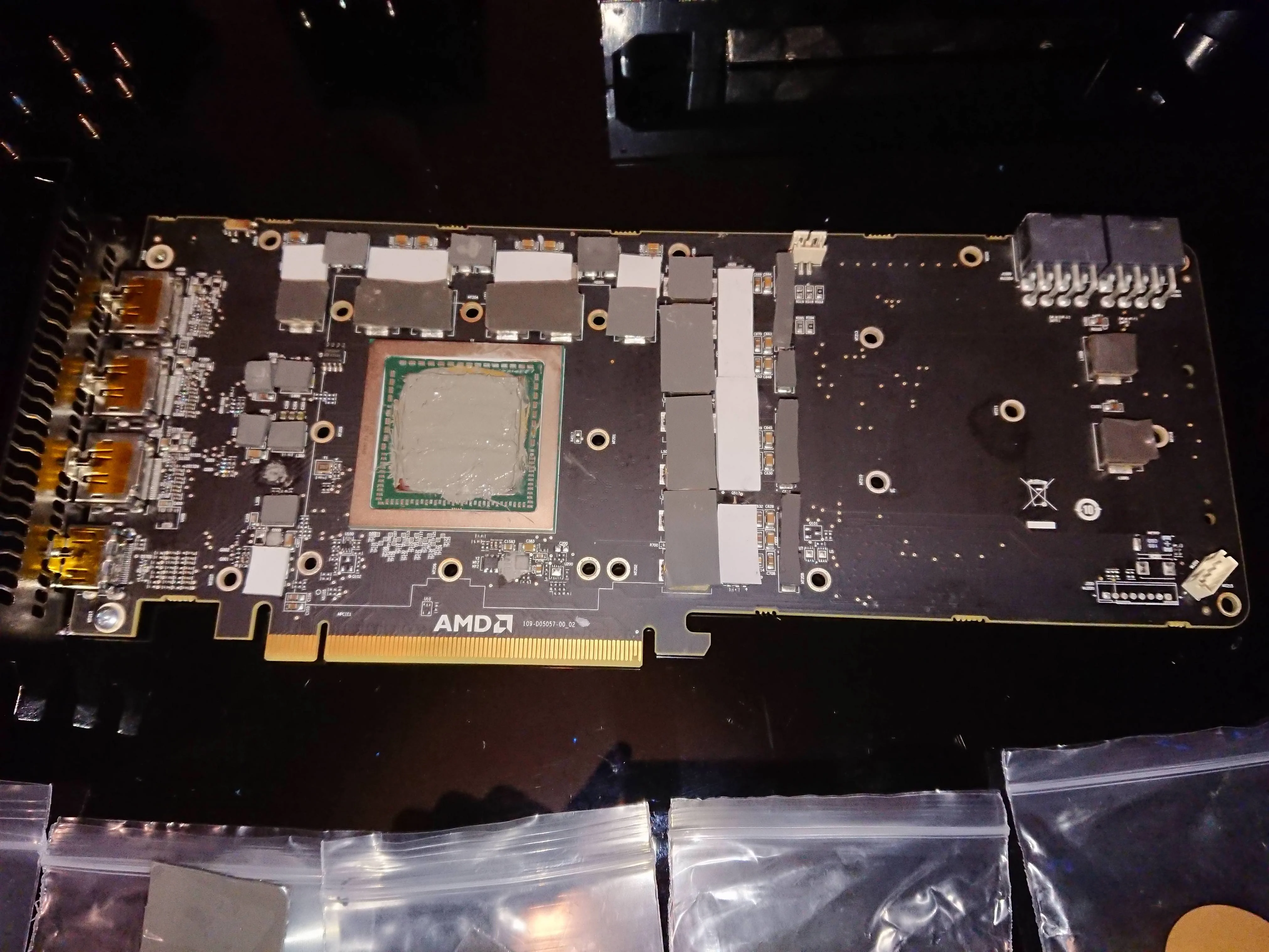

As promised, through a massive adventure of 20+ hours work I finally arrived at success with the eiswolf AIO for vega.
Results#:
Idle
http://gpuz.techpowerup.com/17/11/25/9rr.png
Under Load
http://gpuz.techpowerup.com/17/11/25/6t9.png
Some pictures of my journey.
I know it looks sloppy but trust me after 20+ hours and 6 decontructs and reassembles i was on the verge of setting it and myself on fire.
It looks great, I considered taking this route myself but ended up selling my V64, I kinda wish I hadn't sold it now, Great job.
