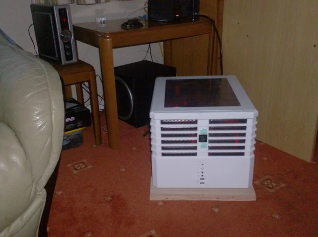

I built this rig, 1600x & V64 in an M-ATX case, In comparison my last build was a 4790k & a Fury Tri-x in a mid tower case that had excellent air flow, even at load it didn't spin up much. I added a 92mm Noctua Redux fan yesterday which is blowing air directly on to the cards fan so hopefully it'll help or at least calm it down a bit. I don't seem to be able to underclock and overclock it much so I need to play around with it a bit more and find it's sweet spot..

Kinda offensive place to have the PC situated is it not!? ;)
