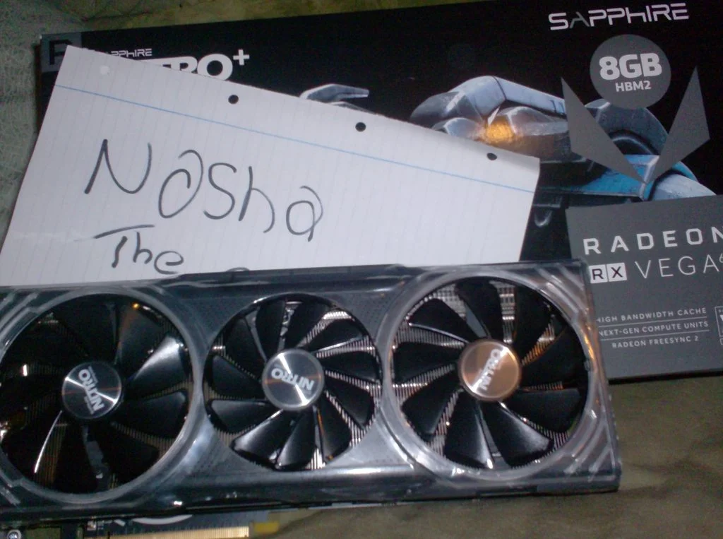

She's here,
One for the ROF please Mr Kaapstad.
Welcome and on TROH.:)
The Roll of Honour.
Date 20/12/2017, Make Sapphire Nitro, nashathedog, Link
