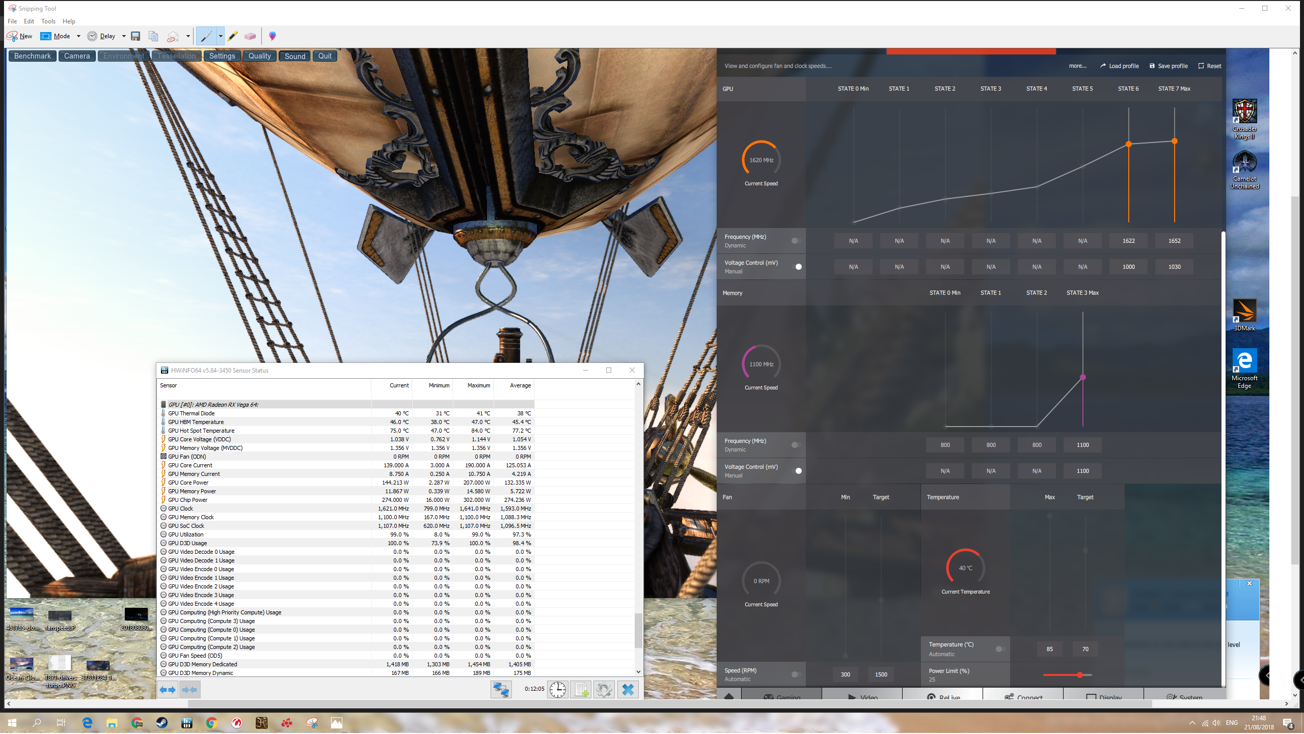

I did some tweaks and got this:
https://ibb.co/mdHjYe
with those settings:
https://ibb.co/cW1dte
I had a little better score with 1650mhz on p7 but i think i can settle with 1637. The fan speed is a bit aggressive and loud but the temperature stay on gpu at 60 - 62°. Do you think i can lower a bit the fan speed? Better to increase the PL to 50?

That's a pretty decent GPU score. Not entirely sure why it wouldn't be translating to gaming performance.
Have you overclocked the CPU at all? What is the RAM speed?
Also you may want to try virtual super resolution and try 1440p or 4k.

Today i changed a bit the fan positions and added a 140 intake fan for more cooling and i think its better. Got almost 7500 in timespy. After reinstalling Destiny 2 i see a nice fps improvement, so maybe i have to reinstall all the games, just to be sure.
Now i'll see if i can overclock a bit more the cpu to 4.1ghz and ram to the rated speed of 3200mhz. Right now its 3000 mhz becouse the asus bios give me problems, but maybe with the new bios it will fix the ram.
Anyway seems like the gpu its going fine! The only problem its about temperatures: yesterday after a heavy gaming session i had 70° gpu, 75° HBM and 80° the hotspot. I don't think i can lower the P7 voltage much more so i'll see with the new fans how it goes :)

What do you think about my temperatures? Are normal or are going to throttle the gpu?
You can always replace the thermal pads on the VRMs with 3mm thick Thermal Grizzly. And since you will be there, replace the thermal paste on GPU & HBM with Thermal Grizzly liquid metal :p
Or at least Cryonaut.
Boomstick has made a discussion in here how he moodified his Strix to improve perf.
Also give a try to the settings found few pages back. They are very efficient (240W), providing really good perf, while they keep the card cool.

After a week and not less than 70 benchmarks in 3dmark I realized that this is exactly the problem. I lowered the floor voltage to 970 and p7 to 1010 and in 3d mark timespy where it does a maximum 60/70 and fps the temperatures have dropped a lot:
60 gpu 65 hbm and 72 hotspots
When I open a game or loop Heaven valley where the fps increase to 140+ the temperatures return very high, despite having the same values in mv and mhz:
66 gpu 71 hbm and 77 hotspots
Wanting to play at 144hz 1080p I'm afraid that there is not much that can be done to reduce the temperature apart from reduce performance to unacceptable levels or putting the card under liquid cooling.

Ignore the hotspot. That is internal part of the Vega 64. I have a custom watercooled card and goes through the roof.
87C is safe for hotspot.
What model is your case? Have you tried to use the system with the side panel removed to see if you truly have very bad airflow in there? How many fans blowing air in do you have?
Is your card new or used? is used, there could have been on a mining rig, and you probably need to replace the thermal paste as it will have been solid like cement by now.
Can you use very fine tweezers to remove the stickers from the two screws on the back and check the thermal paste?
Have you tried the second BIOS configuration? Have you tried those settings here? How does it perform?
